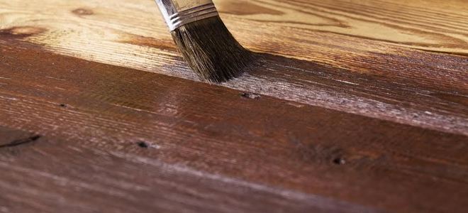

Step 5 - Apply Finish
Start applying the finish by cutting along the edges of the hardwood floor. You should apply a 3-inch border along the wall as this will cover the area that the roller will not reach. Once that is done, cover your shoes with booties and put on a respirator. Using a roller, pour out the finish directly onto the surface of the wood and roll in the direction of the grain before going across it. Overlap with each new row and continue until the entire floor is finished.
Tips
The final coating usually starts to set within 10 minutes, so only pour out as much as you can roll or edge within that time frame. You need to wait at least three house before applying another coat to the surface. The new finish will be fully dry after one week. Depending on the situation, you may need to remove the wall trim before starting this project. If you are unsure how the new finish will look, you can always test it on a small portion of the hardwood floor. If the finish scratches easily, then you probably need to take everything down to the bare wood. Of course, don't forget to check the finish's container for safety instructions, such as whether you need to wear a respirator mask and gloves while applying it.
