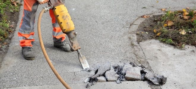

Step 7 - Use a More Powerful Tool
If the sledgehammer isn’t enough to get the job done, the use of a more powerful electric demolition tool may be in order. A 60 pound breaker should do the job and a heavy duty jackhammer should only be needed for very thick concrete, which is not usually installed in home yards.
the tip of a jackhammer breaking a concrete walkway
The 60 pound breaker should be utilized with a chisel point to effectively break up the concrete. As you use this tool, allow its natural force to break the concrete, as it doesn’t require you to push down on it in order for it to work. Move methodically across the concrete, working in pieces about three inches apart from one another to avoid a stuck drill bit. Once you complete this step, again use a pry to break the pieces apart.
Step 8 - Deal With What’s Underneath
Underneath the concrete slabs may exist mesh or bars that were installed to support the structure. As you separate the concrete pieces with the pry bar and uncover these supports, deal with them appropriately. For mesh, use bolt cutters to disconnect them and clear them. For metal bars, use a reciprocating saw or angle grinder.
