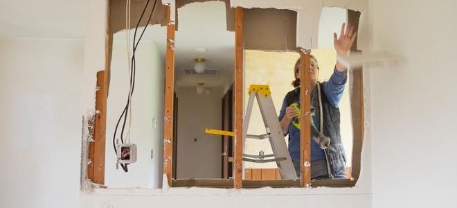

Drywall Removal
Someone demo-ing a wall with a prybar.
While it's tempting to bust out the sledgehammer and get to work, it's easier and more efficient to use a reciprocating saw. Begin by cutting between studs and pulling off large pieces of drywall by hand. Drywall tends to come off easier in large chunks than small ones. Use a small pry bar with a claw attachment for the more stubborn pieces. Remember to wear safety goggles and a breathing mask to avoid inhaling the fine chunks of drywall. Haul away the demolished drywall using construction-grade garbage bags.
Stud Removal
A sawzall demo-ing a wall.
The reciprocating saw is also great in removing studs. With a demolition blade installed, cut through the nails connecting the stud to the bottom plate. You can also cut the wood in half if you want to avoid removing the eight-foot-tall stud in one piece. The saw will also cut through the top and bottom plates, though you can also remove these with a good claw pry bar. Once the wall has been removed, roll up the pieces of plastic, taking special care to trap nail bits and other sharp objects.
