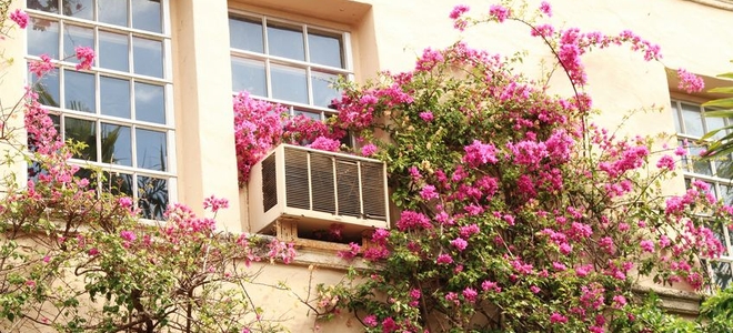

A window air conditioner.
Having removed your air conditioner's front cover, you will now need to remove the foam padding that is pressed up against the sides of the device. As the insulation is firmly in place, you may need to use your hammer's prying end to successfully extract it. Next, use your screwdriver to detach the air conditioner from its wooden base, taking special care to make sure the freshly detached device doesn't fall.
