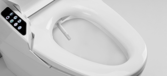

How to Remove an Upflush Toilet
An upflush toilet.
