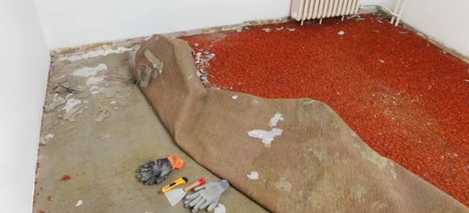

Chances are you are already spending hundreds, maybe even thousands, of dollars if you are replacing carpet or installing new flooring. In order to save some money, you can remove the old carpet yourself before the installers arrive. This saves both time and money and is easier to do than you might think.

Pull up the carpet from the tack strip along the walls. Start in a corner of the room and grab the carpet with pliers and pull.
how to remove carpet
Now grab the carpet by hand and continue to pull it up along the entire length of the wall. Fold back about three feet of carpet and cut it into easy-to-handle strips using a utility knife. Carpet is much easier to cut from the back than from the front, so folding the carpet over is a great strategy. Use a sharp new blade of the utility knife.
Be careful not to slice into the baseboard or walls. Duct tape can be used to roll up the strips of carpet for easy handling.
