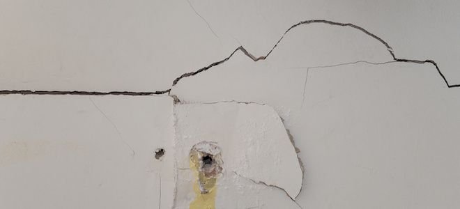

When you are remodeling a house, you will often need to remove the drywall as part of the refurbishment. This can be a very messy and difficult job. On TV shows, you see people using sledgehammers to destroy their drywall. This is unnecessary and just a stunt for TV. In reality, you should be a lot more careful so you do not hit pipes and wiring.
