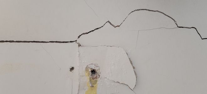

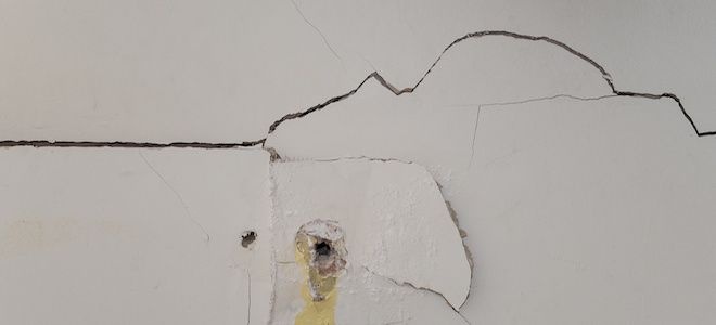

Step 4 - Remove Drywall Approaching from Back
A hole in drywall.
If you cannot reach the back side of the drywall, use a hammer to make a small hole into the drywall. Make a hole near the edge of the drywall but away from the nails. Insert your hand and hammer into the back of the drywall. Tap on the back side of the drywall to remove it.
