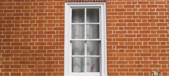

Sash windows were once very popular but they have fallen out of fashion for quite a few years now. Ripping these sash windows out and replacing them with something more modern is actually very easy.
Step 1 - Getting to Know Your Window
The first thing you need to do is get to know your sash window. Most sash windows in America have pretty much the same specifications. There are two sashes to most windows which are fitted with glass and have stops to prevent the glass from sliding out. There are two different stops, which you will have to bear in mind.
