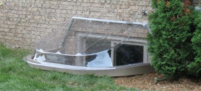

An egress window well is a great way to not only add more safety to your home, but to also great value. The egress window is a large area built into the concrete foundation for easy escape in the event of a fire or other disaster.
Egress window wells are made of a wide variety of materials, such as wood timbers, concrete blocks, and bricks. You can even purchase prefabricated egress window wells for ease of installation. With a concrete block egress window well, there is the chance that you will need to repair portions of the wall if the blocks crack. Here are some steps to do the job with little problem.
