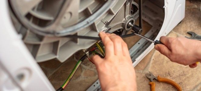

Step 5 - Dismantle the Machine
Tearing apart a dryer is not difficult, but it does require attention to detail. Typically there are small screws inside the door that release the top of the dryer and more screws inside the top. With the top off, you can remove the front, but watch out for wires that connect it to the electrical components.
It’s easiest to dismantle the machine when it is laying on it’s back, but be sure to place it on wooden blocks so the exhaust flange for the dryer hose doesn’t get crushed. This will provide access to the drum, motor, heating element, rollers, and more.
You may not need to remove the front and top parts of the dryer, though. Before you try that, you can remove the back panel instead to access the fuse and thermostats—common culprits in a malfunctioning dryer.
Step 6 - Test the Components
With the back of the machine off, grab a multimeter to help identify the problem. Put the probes on either side of the main thermostat and look for a reading or listen for a beep, depending on your multimeter model. Next, test the secondary thermostat. Finally, test the fuse. If the multimeter fails to register at any of these points, you’ve identified the problem. Replace the faulty part and you should be back in business.
