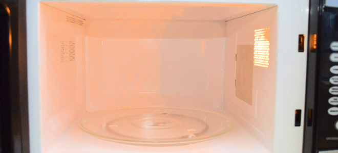

Microwaves come with many features and differences, but one thing that is fairly standard is the microwave turntable. This handy gadget sits on multiple little wheels and allows food to cook evenly while the microwave is running. As a simple addition to the microwave, it can become very annoying when the turntable becomes jammed or stops rotating. To determine the cause of the jam it is important to be sure the motor is still working effectively and doesn't need to be replaced. In some instances, the turntable stops working due to a motor malfunction rather than debris in the track. To troubleshoot this issue and repair the jam, follow these steps.
Step 1 - Check the Track
Look at the turntables base, guides, wheels, and track to be sure that excess food goo, melted cheese, or some other substance hasn't gummed up the space. If the wheels cannot turn, or the track is blocked, the turn table will not rotate. Unplug the microwave before spraying or cleaning. Use an old toothbrush and some vinegar to cut grease and grime from the track space. Allow the vinegar to sit for 10 minutes before brushing away any debris.
