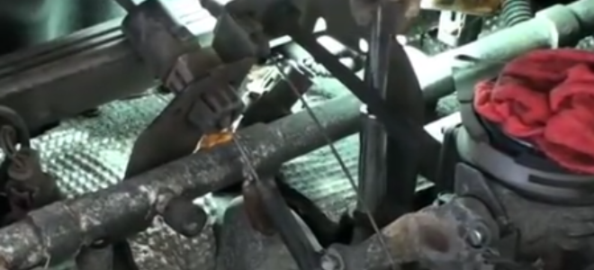

Step 5 - Prepare Throttle Cable
Take the ripped throttle cable and cut off the ripped end. This will shorten the cable a bit but will not greatly affect the throttle mechanism. Now, insert the 'new' throttle cable into the hole in the copper tubing and pull it out of the bigger opening. Fray the end of the throttle cable so that it remains stable inside the tubing during soldering. After fraying, pull back the throttle cable enough so that only its end remains inside the copper tubing.
Step 6 - Solder and Finish the Job
Apply a lot of flux to the tubing and throttle cable to prevent oxidization during soldering. Now, using pliers to hold the cable, solder the throttle end with the copper tubing until the tubing is filled with solder. You will know there is enough solder when some of it starts crawling up the throttle cable. Stop right then. Your throttle cable has been repaired and is ready to use.
