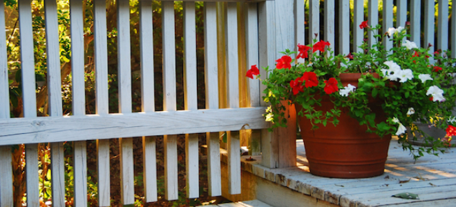

Your porch railing is the first thing that people see when they approach your home. It gives a first impression that lasts so keeping it in good condition is important. A rotting porch railing is also a safety concern. Time and moisture can cause the wood railings and posts to rot, making it important to check the railings regularly. It is not hard to repair small rotting sections of the railing with only a few tools.
This method of repair can be used on any wood railings, and also for rotting window and door frames but not for load-bearing structures.
