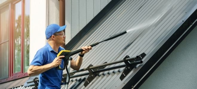

A man cleans a roof.

Whatever repair method you use, it is necessary to prep the area so that the patch, coating, or paint that will be applied will adhere firmly on the surface. To do so, wash the area with a detergent solution and then rinse with water. Next, mix oxygen bleach and water at 50:50 ratio and use it to remove organisms such as mold or algae from the surface, which can affect the adhesion of the patch, coating, or paint. Allow it to dry. Apply paint stripper on the area and then scour loose paint and the primer using a putty knife. Use a wire brush if necessary. Sand the surface afterward, using medium grit sandpaper.
