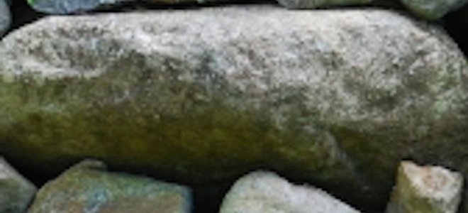

Step 3 — Replace Stones
Determine the type of stone that was used to build your foundation. Three common types of stone used on foundation are limestone, sandstone, and rubble stone. Out of these three types, sandstone is the softest and rubble stone being the hardest. Knowing what rock you have is crucial because the expansion and contraction rate is different from stone to stone. This is also the case with the mortar to be used for the repair. Expansion and contraction will affect the mortar, so it also has to be selected for the job at hand. If a harder mortar is used with a softer stone, during the expansion process, the stone will press on the mortar, which is harder, thus causing the stone to crack.
To replace a stone that has loosened, cracked, broken, or chipped, chisel away the mortar from around the stone until it can be removed from the wall. Clean around the exposed areas in the wall; pick a stone that will fill the void allowing space for mortar on all sides.
Mix the mortar as per instructions from the manufacturer, depending on the amount of mortar needed, mixing can be done by hand in a wheelbarrow or larger amounts you may want to use a mixer.
Using a pointed trowel, lay down a thick bed of mortar on the bottom of the opening for the stone to set on. Slide the stone through the hole and rest it on the bed of mortar. Now use the trowel to force mortar around the stone on the remaining three sides. Make sure that the mortar goes completely through and out the other side.
Clean up the mortar line with a brush to give a clean, professional look.
