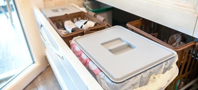

How to Repair a Trash Compactor
a trash compactor in a pull out cabinet
