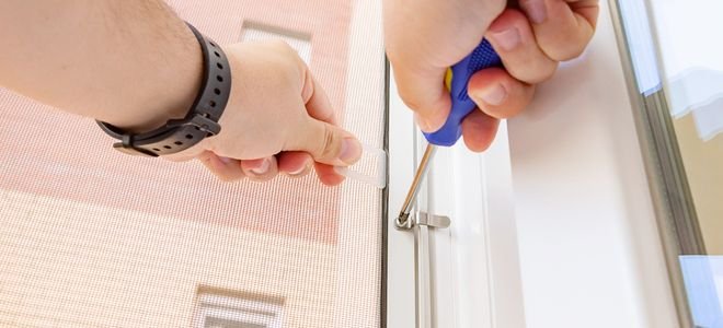

How to Replace the Entire Door Screen
hand repairing screen door with rolling tool
Step 1 - Remove the Door
Remove the aluminum screen door from the hinges, and then set the door on a flat work surface.
Step 2 - Remove the Screen
Use a utility knife to carefully cut out the rubber splines that holds the wire mesh screen in place. Once you have cut out all of the spline material, simply remove the screen and set it aside.
Step 3 - Measure and Cut Screen
Measure the height and width of the screen opening on the door. Then, transfer the measurements to your replacement screen and cut to size with a pair of heavy duty scissors or shears.
(Note - Add about one inch to the height and width measurements before cutting)
Step 4 - Install Screen and New Splines
Use the spline tool to force the screen into the slots on the edges of the screen border. Then, use the other side of the spline tool to press the spline material into place. Do this for all four sides of the screen opening. Trim the excess screen with a utility knife or scissors.
(Note - It is usually easier if you do the left side of the screen first and then the top side of the screen (as the door faces you). This will make installing the spline on the lower and right-hand side of the screen door much easier. It will also allow you to tighten the screen as you go.)
