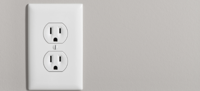

If you have an outlet that is making buzzing noises or from which you notice sparks, you should look into it by immediately turning OFF the circuit breaker and repairing the electrical outlet immediately to eliminate the risk of a fire in your home. When you hear strange sounds or see flashes of light from an electrical outlet, the best method of fixing the problem is simply replacing it with a new one. Fortunately, replacing a defective outlet is a relatively easy task that the average DIY'er can perform in about half an hour or so. This simple how-to guide will show you everything you need to know.
