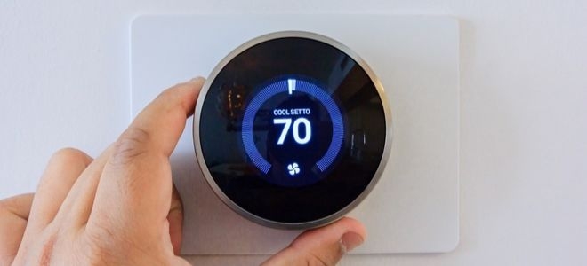

thermostat that reads 70 degrees

Be careful not to add too much water. There can be a failure with the thermostat. Make sure the appropriate thermostat setting is on. You want to maintain the thermo level in heat mode. Other issues with the thermostat might be that the battery level is low, the circuit breaker might be fused, or the wires may be loose.
