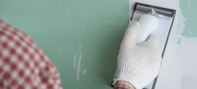

Step 5 - Sand the Seam and Reapply Mud
Allow the drywall mud on the seam to dry. Use your sandpaper to smooth away any ridges or bumps. Then, with your knife again loaded with thinned drywall mud, float it down the seam, matching the surface with that of the wall around it. Let it dry, sand again, and you are now ready to apply primer.
WARNING: To avoid getting any drywall mud particles into your eyes or lungs, wear safety glasses and a face mask while sanding (especially if you use an electric sander rather than sanding by hand).
