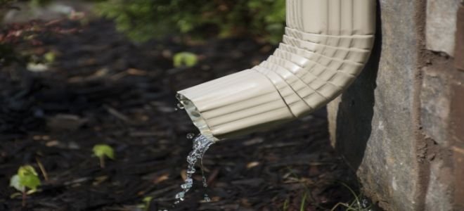

Household gutter systems are prone to leakage, caused by separated or leaking gutter downspouts. A gutter downspout is in the form of a hollow, pipe-like tube that collects the drainage water from the gutter and drains it away into the drainage or water-renewal system. Downspouts are susceptible to jarring and other forms of surface injuries induced by vibrations in the surrounding ground. Leaking or separated gutter downspouts can be easily repaired using some basic tools and the following guidelines.

Inspect the leaking downspout. Most of the leaks are due to broken silicone or caulk joints. These joints are prone to breaking due to the downspout surface issues, internal water pressure, and action of chemical solvents found in water. Using a knife, cut off the existing silicone or caulk layer. You need to free the joint from the old sealing material to re-seal it. It also enables you to inspect the extent of the damage. Repairing the leaking or separated gutter downspout only makes sense if the crack can be properly re-sealed without compromising the structural integrity of the gutter system. Otherwise, seeking a replacement is recommended.
Step 3 - Clean and Re-seal Leaking Gutter Downspout Using Silicone Caulk Tube
Using a brush and a solution made of water and dish soap, clean the joints of the leaking downspout. This is vital for the bonding that will establish the sealing compound. Use silicone-strength caulk for re-sealing. Silicone caulk is more impervious to water-induced damage. Insert the silicone caulk tube into the caulk gun. Using a knife, slice off the tip of the silicone caulk tube. Ensure to maintain an angle of about 45 degrees while slicing the tube. This ensures a smooth stream of caulk. Ensure that you squeeze-out a thick bead of silicone for re-sealing only onto dry surfaces.
