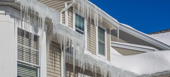

Severe winter weather brings moisture, wind, ice, snow, cold temperatures, and rain. It also makes us grateful to have shelter from the elements. But that shelter often takes a beating when Mother Nature rains down her fury. Some common problems that occur during winter are damage to roofs, gutters, siding, decks, pipes, and foundations. Spring and summer are a great time to see what damage may have occurred so here’s a checklist of common damage areas around the home to get you started on your inspection and repairs.
Roof
A man fixes a roof.
Damage to the roof is a very common weather-related issue and one to be taken seriously since a leak in the roof will eventually bring the entire structure down. Depending on where you live, different weather elements can damage the roof in a variety of ways. For example, the weight of heavy snow can move shingles around and cause spots to sag. When all that snow melts, the sandy material on the shingles can be washed away, which prematurely deteriorates the shingle. During times of freezing, warming, and refreezing, the snow melts enough to run down the roof and then refreezes under the edge of the shingles, creating an ice dam that lifts the shingle.
Shingles can also be damaged by heavy rains or high winds. This opens the door for leaks and should be fixed each year. If you notice the damage during the cold season, a well-secured tarp over the area can tide you over until the weather warms a bit. To fix the issue, make sure you identify each shingle that is damaged and those that are deteriorating. The repairs are not difficult if you can access them. Simply remove the old shingles and attach new ones in their place. To remove shingles you can either cut off the damaged shingle tab with a sharp utility knife or pry off the shingle completely. Tuck the new shingle beneath the shingle above it and make sure it overlaps the shingle below it. Secure it into place with roofing nails, which are easily found at any hardware store. Then secure the lower portion of the shingle to the roof with a few dabs of roof cement.
