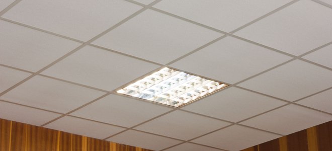

The compact fluorescent lamp or CFL ballast is an essential element of a fluorescent light. In fact, it is the component that actually makes your light bulb work. A CFL ballast is electronic, and when the ballast begins to deteriorate, there will usually be warning signs that let you know your ballast is beginning to go bad. Your light bulb will begin to flicker on and off, or the fixture will become noisy. In either case, replacing the ballast is not difficult, and you can easily do it by following the steps below.
