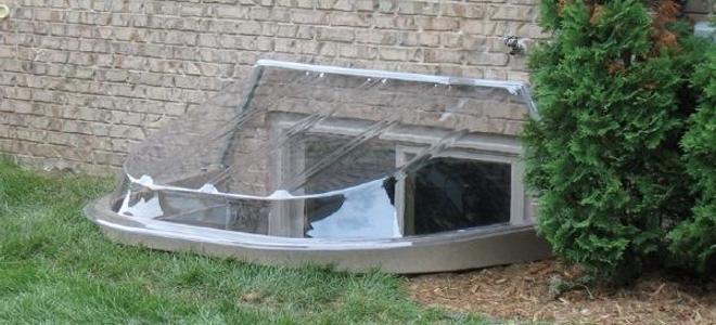

If you have a concrete block window well in your home, whether it is being used to capture the ends of a sash cord or to hold soil away from the window, it is partially below the ground. You can build a well using concrete blocks or create one from a steel window well which has been pre-built. If you need to re-add the concrete block due to soil being moved or after a frost has cracked the concrete, then you need some basic gardening tools, concrete blocks, and a few spare hours to perform the task.

Once you have finished installing the blocks, you can cover the area with asphalt mastic. It will allow you to place a metal or wooden frame over the top of the concrete blocks, giving them additional support. You should allow the cement and the mastic to dry in position, then backfill or leave the path as it is. In order to prevent the ground from collecting dirt or being flooded by trapped snow, you should add a roof or a plastic hood to the top of your window well.
