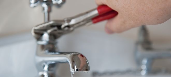

Perhaps you have considered upgrading your faucet and are wondering whether it is a job you can complete yourself. It is not as difficult as you may have imagined. In fact, a couple of hours and some basic tools are all it takes. When properly replaced, a new faucet eliminates leaks or drips that you may have had with the old faucet. It also enhances the appearance of your sinks and improves water flow efficiency. This step-by-step guide walks you through how to get the job done right.
