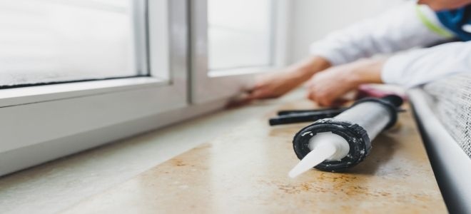

Step 4 - Add the new Window Frame
Slot the window frame into position. The jalousie window usually has a metal frame which means that you will not need to use shims or levels to work out the correct angle. Instead, push it into position firmly, and then apply screws to the holes in the frame. Tighten these by hand, and then screw them tightly into position. If there are significant gaps around the edge of the window, you may consider adding some caulk to the surrounding spaces.
