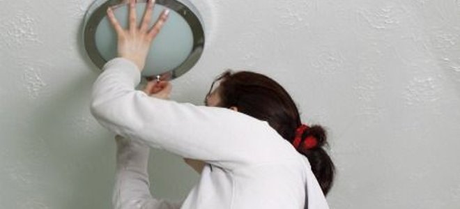

One change to your home's atmosphere and decor that's both easy and instantaneously effective is replacing an old, outdated light fixture with a more stylish one. Replacing a light fixture is an easy job that most average DIYers should be able to accomplish in about a half hour. If you have an old light fixture you want to replace with a new one and you need a little help, here's how to do it.
Step 1: Turn Off the Power to the Light Fixture
Check the electrical panel's chart to see if the breaker for the light fixture or the part of the home where it is located in is labeled. If it isn't, then turn the light fixture on and turn off the breakers individually until the light goes out. Once you find the correct breaker, place a piece of electrical tape over the breaker and post a sign on the panel cover notifying others that you are working on the power. When you return to the light fixture, turn the wall switch off (if it is controlled by one).
Step 2: Disassemble the Existing Light Fixture
If the fixture was previously on, wait until it has cooled before you start to disassemble it. Remove the cover lens first and then unscrew the light bulbs. Depending on the type of fixture it is, there may be two screws securing it to the mounting bracket or there may be a single threaded nipple with a nut holding the fixture up.
If there are two screws, loosen them and then turn the fixture so the screw heads can slide through the larger slots on the fixture body to release the fixture from the mounting bracket.
If the fixture has a threaded nipple with a nut, simply remove the nut and slide the fixture down and away from the nipple.
Before your disconnect the wire connectors it is important to double check to make sure you turned the correct breaker off. Test the black wire for voltage using a non-touch voltage tester. If the tester does not light up or make a sound, then the circuit is off. Disconnect the wire connectors and remove the old fixture.
