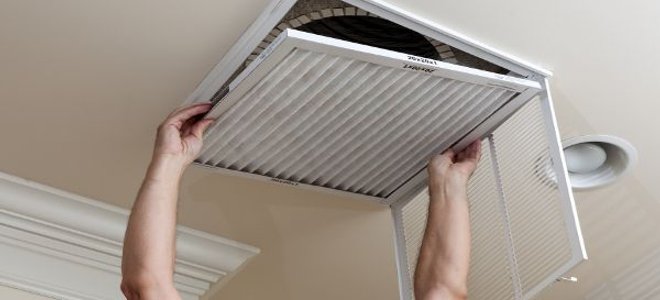

Step 1 - Locate and Remove Filter
Some may be located behind the main vent that lets out cool air into your house, in which case you may need to pull back a set of fasteners to remove the filter from its housing. This vent is usually located by the thermostat. In other cases, the filter may be located in a slot in your furnace. Before removing the filter, make sure to turn the unit off for safety's sake.
Furnace units that use larger media filters will have them behind a filter cap, a metal or plastic housing that can snap off by hand. Once you have found the filter, making sure no air is going to pass through the system while you work, remove it.

Step 3 - Install the Filter
Once you have the correct unit for your air conditioner, slide it into place. There should be an arrow telling you which side to put it in first, and it is important that you follow this as the filters are designed to work this way. Put the filter cap back on or refasten the grate. It is now safe to have air flowing again.
