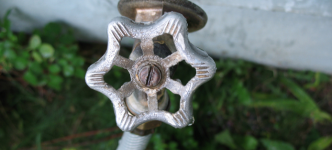

As a homeowner, you will eventually find yourself needing, or wanting, to replace an outdoor faucet. It may be because one of your faucets is leaking, or maybe you have another faucet that will better suit your aesthetic tastes. But when the time comes for you to replace your faucet, you'll either need to hire someone to do the job, or you'll do the replacement yourself. If you find yourself choosing the latter, you'll need a few suggestions, such as those below.

You'll need to unscrew the faucet from the water pipe that feeds into the faucet. This will require that you hold the pipe from turning. Very likely, you will only be able to do this if you hold it with a pipe wrench. Adjust the wrench jaws until they barely fit over the pipe. Place the pipe jaws over the pipe so that when you apply pressure to the wrench handle, it is trying to turn the pipe clockwise.
Then, place the adjusted jaws of a second pipe wrench around the faucet head in a position that is reverse from the first wrench. That is, pressure on the handle pushes the wrench counterclockwise. While applying pressure to the first wrench to keep the pipe from turning, add pressure on the second wrench until the faucet breaks loose on the pipe. Finally, turn the faucet until you have removed it from the pipe.
