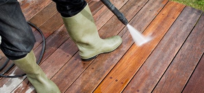

Step 1 - Prep Work
Before you begin the process of resurfacing your wood deck, you will need to power wash it and repair any loose nails.
After clearing all the items off of your deck, wash the surface and allow it to dry for a day or two. Make sure you don't have people around when you power wash to protect against injury. Also, take care not to keep the tip of your power washer too close to the deck surface while washing or you risk permanently damaging the wood. After, use your hammer to pound in any nails that have worked their way up out of the wood. If any nails are loose, pull them out and drive a 3-inch decking screw half an inch away from the hole.
