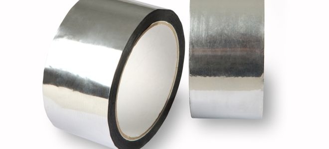

Step 2 - Tape Small Leaks
Gaps less than ⅛ inch wide can be fixed with mastic or foil tape, specially made for the job and easily found at any home improvement store. Don’t assume just because a seam is wrapped in duct tape it's leak-free. Duct tape is not a good option for heating ducts because it will eventually break down, dry out, and create gaps. You can cover duct tape without removing it, however.
Whether there is an existing tape or not, make sure to clean the seam before applying the foil tape. It will not adhere to moisture or dust particles. When the surface is ready, peel the backing off the mastic tape and apply to the seam—press it firmly into place all the way around and test for any air leaks.
If your seam is at a junction, it may be more difficult to get a solid seal. Use several smaller pieces of foil tape to fill spaces, then wrap a larger piece around the smaller ones to ensure a tight seal.
