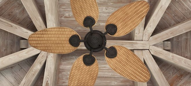

Step 2 - Blade Size
Blade size is measured two different ways, depending on the number of blades in the fan. For odd numbers, measure from the tip of the blade to the center of the fan. Once you have the correct measurement, multiply the number by two. For even blades, measure the complete distance from one blade tip to an opposing blade. No further calculations are necessary.
Step 3 - Blade Span
With the square footage of the room and blade size figured out, you can now determine the appropriate size of the fan. For rooms less than 75 square feet, the blade size should range from 29 to 36 inches. For rooms that are between 76 and 144 square feet, a fan blade length of 36 to 44 inches is appropriate, while 144 to 225 square foot rooms should utilize a 44 to 54 inch blade. Fan blades that are 50 to 72 inches can be used for large rooms that range between 225 and 400 square feet.
