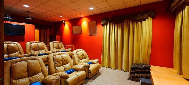

Soundproofing the ceiling is useful, if not essential, in specialized rooms such as home recording studios, home theater rooms, and even workshops where you'll be using power tools. This is pretty easy to do by installing aluminum hat channels.
