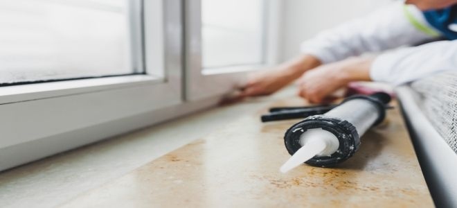

Step 1 - Sealing the Existing Windows
This process is known as "plugging" because you are essentially plugging the windows from the inside with caulk to help stop sound from escaping the seams of the window. Take a look at the windows in the space you want to soundproof. Place your hand around the edges and feel for air. These drafty spots are where sound will easily escape. Use the caulk to seal these areas. If you cannot feel any air then you may skip this part because the windows are already properly sealed.
Step 2 - Cutting the Soundproof Foam
The foam is the most important part of soundproof windows in this "plugging" method. Use the measuring tape and measure the width and the height of the windows to be soundproofed. Double and triple check your measurements because you want this to be as precise as possible. Once you are certain you are correct; begin cutting the foam. The foam has to be cut to these exact dimensions; any inaccuracy to make the entire project moot. Straight lines as well as adherence to the measurements are equally as important. Remember, you are plugging the window so the foam you are cutting has to fit the window snugly.
Step 3 - Installing the Soundproof Foam
Place the foam you cut within the window frame. Do not press it against the window. You want an air pocket to remain between the window and the foam. This trapped air acts as another barrier to the sound; preventing it from escaping. This is why the foam had to be cut precisely and fit tightly inside the frame.
Step 4 - Sealing the Foam
If the foam is very snug and there are no gaps present, you can skip this step if you wish. If you want to further dampen the sound, use the tape to seal the edges of the foam. The foam is now effectively the window and the tape is the new caulk. You most likely will not want to seal a window up for all time so using masking tape to seal the gaps between the foam and the window frame will be a better solution than glue. To remove the foam you would just need to remove the tape and pull the foam free. The caulk you added in Step 1 will only serve to better your heating and cooling efforts.
