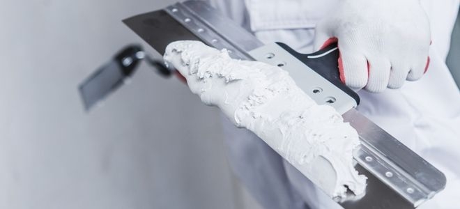

After you remove whatever caused holes in the wall such as pins, nails and hooks, you will be left with a lot of unattractive blemishes. The first thing to do is obtain some drywall spackle and a spackle knife. Purchase the kind that dries white. Since many interior walls are white, this is the easiest kind to work with. In addition to the spackle and the knife which is just like a putty knife, have a dish of water and a clean rag.
Application
Scrape a small amount of spackle onto the knife and smear it over the hole you are filling. As you do, run the knife flat against the wall and drag the spackle over the hole. Don’t apply too much, just enough to fill the hole. Dip the clean rag into the jar or dish of water. It should not be saturated. Squeeze it out if it is. Rub the moist rag over the spackled area in a circular motion. There is no need to press too hard. Your goal is to work the spackle in to fill the hole while at the same time making it look like there was never a hole there.
If the wall is white, you should be able to immediately notice your handiwork. Spackle does not take long to dry. Working the spackle in with the towel de-textures the fill-in material. Stand back, and you should not be able to see much difference between the fill and the surrounding. Once satisfied, move on to the next hole. Bigger holes require more spackle to fill them in, but work it in with the moist rag in the same manner.
