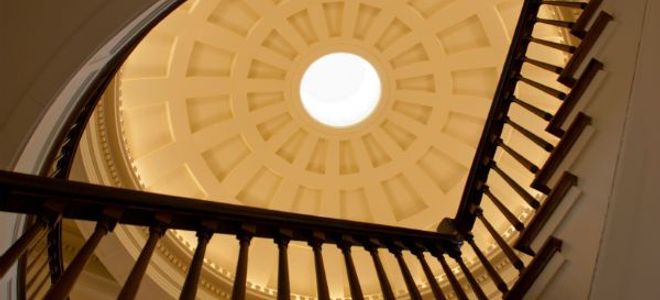

How to Stain Stair Railings
view looking up a staircase with a handrail
