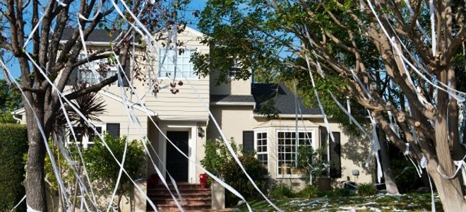

It's disappointing to wake up November 1st and realize the house was the target for the neighborhood frat party or ground zero for the local high school crowd. After all, part of the fun of being a Halloween "trickster" is knowing how difficult toilet paper and eggs are to clean up. Here is a short review that might help get things moving. The supplies listed below are for worst case scenarios -- actual needs will depend on how devious the urchins were. Remember, most messes are best cleaned up before too much sunshine.

Toilet Paper
Having a toilet papered house is just flat out embarrassing. There are mixed opinions on how to deal with the aftermath, but the most important factor is to remove it as quickly as possible. Loose bits will quickly spread across the neighborhood and any grass that is covered in it will smother. The key to TP cleanup is to start before morning dew or wait until it has baked dry in the sun -- wet TP is frustrating to tackle.
For tall trees and rooftops, break out a sturdy ladder and swat away with a broom. (Keep an extra eye out for power lines.) Then, collect the smaller pieces from the ground with a rake and trash them. When the TP is tangled in lower bushes and shrubbery, turn to the leaf blower and blast the little squares loose. But be careful -- this can be tricky for anything with thorns, especially roses. Do not allow TP to disintegrate around roses as it will encourage mold growth once it becomes wet.
