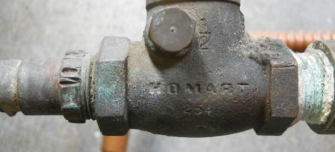

There are two kinds of backflow devices: a reduced pressure principle device and double check valves. Examine the kind of device that you will be testing. Also investigate the direction of the water flow. Arrows or wording provided by the manufacturer on the device will inform you.
Step 3 - Gather and Number Cocks
Gather the amount of test cocks and bushings that you need. Ascertain that they are clean and free of debris or dust, and number the cocks.
Step 4 - Observe Valve
Shut off the downstream (number 2) shut-off valve. Wait several minutes when testing a reduced pressure principle device before hooking up the test kit hoses. Emanating water from the valve indicates that the first check valve is most likely fouled and needs to be serviced before you can continue. Exiting water from the double check valves, however, are not indicative of any concern.
