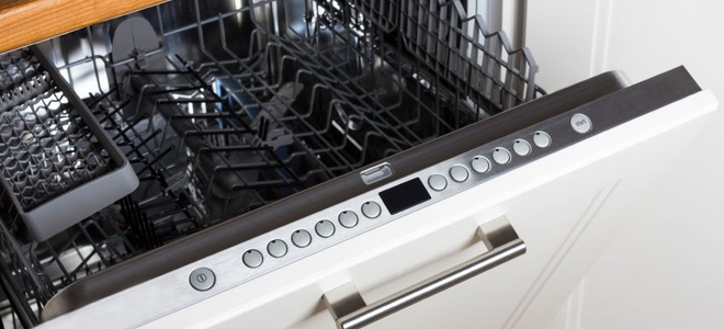

If you are experiencing problems with your dishwasher, it is helpful to know how to test a water inlet valve. These valves are controlled by one or two solenoids. Over time, either the solenoids or the seals themselves can fail.
