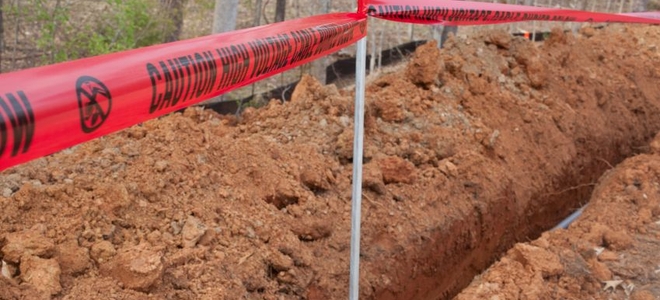

A ground rod.

The function of any ground rod is to dissipate the current that is recovered in any faulty electrical circuit near your house to the earth surrounding the ground rod. If you do not have one already, you can easily install a ground rod for your home. The rule is that the lower the resistance it has, the better job it does. However, over time the moisture of your soil, the corrosion of your ground rods, the loss of contact of your wires, and more may increase your ground rod’s resistance. This is why strict monitoring on your part is imperative. The safest way to test a ground rod is by using a clamp-on Ground Tester.
