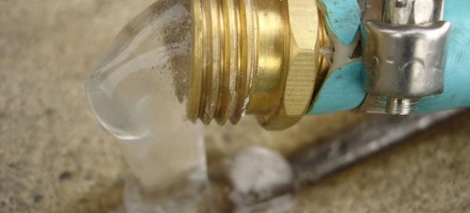

As Old Man Winter blows across the country, he brings with him a plentitude of freezing temperatures and gusting winds. These cold weather scenarios set the perfect stage for freezing pipe problems. There are many situations within a home that can lead to frozen water in pipes. Poor insulation, extremely low outdoor temperatures and faulty thermostats are just a few of the issues that can cause problems. Unfortunately, frozen pipes can lead to unwanted and costly repairs, but there's no need for stress if you've found yourself needing to thaw out a pipe. Before you follow one of our methods listed below, go through the following steps to control your water flow.

Method 1: Warm Towels
Here's where you thaw the pipe. There are several methods that you can use. For the first, turn on a hot water tap from another area in the house. Place a bath towel in the sink and soak it in hot water. Squeeze out any excess water and then wrap the warm towel over the pipe. Leave the towel on the pipe long enough for it to thaw.
Method 2: Hair Dryer
If the warm towel does not provide enough heat to thaw the pipe, try this second method of using a hair dryer. Plug the hair dryer into a nearby outlet. Turn the dryer on and point the blowing warm air toward the frozen area of the pipe. Begin applying the heat at the section of the pipe that is nearest to the faucet so that the water will run through it and reduce built up pressure.
