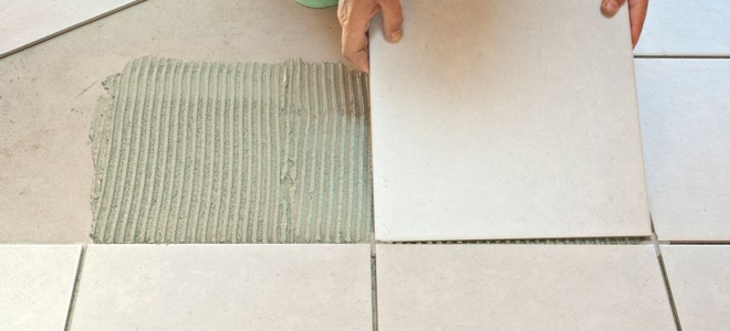

Apply Mortar
You can dampen the floor with a sponge to prevent the mortar from drying too fast. Using a trowel, brush on the mortar in one direction to avoid air pockets. Work in small sections at a time, so that the mortar won’t get too stiff to work with.
Set The Tile
Open a few cartons of tile and mix them together. This will help mask slight variations in color and texture. Using your chalk line, set the tiles in place and firmly press down to embed them into the mortar. Make sure the corners of the tile aren’t tipped up and inspect each piece before moving forward. You can use spacers to ensure all the gaps are even.
