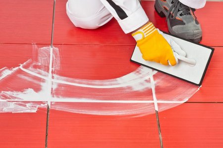

A DIYer with a rubber trowel applying white grout on red tiles.

Step 7 - Grout and Finish
Use a trowel to pack the grout into the joints. It's important the joints are completely filled to reduce the risk of loosening later on. Then, scrap off as much as the grout as possible.
When the grout stiffens, but isn't completely hard, clean off the excess using a sponge and warm water. If there are areas of grout that are too difficult to get out with the sponge, use a abrasive scouring pad, but be careful not to scratch the tile.
Use a dry cloth to wipe down the tile before the water dries. The next day, caulk the joints, put on the baseboard and toilet and install the door after cutting it to proper length. Congratulations, another DIY project complete.
