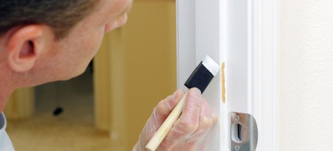

Step 5 - Prep the Surface
A man touches up a wall's paint.
Use a damp and soapy sponge to wipe down the surface you’re planning to paint. Then, rinse the wall with a separate sponge that is damp but devoid of soap. Gently dry the wall with a clean towel.
Another part of prepping the surface you’re looking to paint is to prime the wall. Use a latex primer, careful not to go outside of the perimeter of where you’re looking to touch up.
If you’re painting to cover holes or to mask a dent, you’ll need to first actually fix the problem before you paint. A simple layer of paint won’t rid your walls of these issues, so be sure to fix them before you reach for your paint can for the best possible results.

Step 7 - Paint Where Needed
You’re now ready to paint areas that require touching up. Use the “feather” technique to create a smooth transition between the spot that needs some TLC and the rest of the wall. Brush with extended strokes that reach beyond the touch-up area or use a roller to paint from the center of the area, gradually lifting the roller away from the wall as you extend your stroke.
You’ll want to paint in multiple directions to effectively camouflage your patch job. Think of the paint job in the shape of a sunshine, making the patch the middle and painting in a multitude of directions around it, like the rays of the sun.
As you’re painting, start with very little paint on your brush or roller. It is much easier to add more paint if needed than it is to take it off if you originally put too much on.
