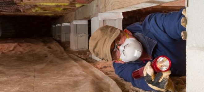

Signs of Mold or Mildew
If you suspect that you have mold in crawl space areas or you know this is a moist area of the home, you need to check for signs that indicate you have fungi growing here. It’s a good idea to perform a regular mold check of the crawl space and any other areas of the home where it could potentially begin to grow.
You should always wear breathing protection or a particle mask when you suspect and look for mold. If you find mold in moist areas, it is important to note the color of the mold and its general appearance.
However, you should not attempt to touch or disrupt the mold in any way during your inspection. Be careful not to spread the mold, and be especially careful not to inhale it.
First, assess the state of your crawl space. Note how the air feels and how it smells, and of course, look for any moisture and feel for any humidity with your skin.
Notice any musty smell in crawl space areas or any other crawl space smell you might detect. When a crawl space smells musty, this is a strong indication of mold or mildew in crawl space areas.
If moisture is excessive and ventilation is poor, mold has the right conditions to grow and flourish. If the air is stuffy or if there is a bad smell that is somewhat musty, mold growth has already started.
Get out a flashlight and inspect thoroughly if you smell a musty odor or if you have spotted unnecessary moisture in the crawl space. Look for mold in the corners and search for any moist areas in particular.
Mildew has a gray or white color to it and a powdery appearance. It also grows quite flat, right against whatever surface it is on.
Mold grows in shades of blue, red, green, and black and has a more moist or slimy appearance. It may also appear to be fuzzy, and it does not always grow flat.
Do the best you can to identify the mold or mildew growing in your crawl space. Take some pictures of the growth, if necessary, to try to determine which type you have.
