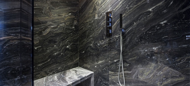

A thermostatic shower has a pre-set thermostat that will sense a dramatic change in temperature and correct it avoiding extremely high temperature for the user. Some thermostatic showers will even cut the water source off when there is a problem detected. This is perhaps one of the best options you can install in your bathroom without having to worry about water being too hot because inside is an automatic adjuster that maintains temperature by adjusting the flow of each water supply.
When the water temperature starts to go down the system will lessen the flow of cold water to balance the temperature. The same works for hot water flow so that scalding can be avoided. This type of thermostatic shower is dependent on water pressure created by the hot water. Certain problems do arise and must be addressed to ensure proper function.
