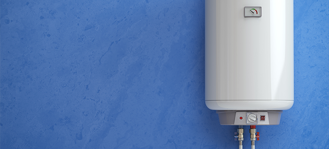

If you own a home, chances are you will eventually face a failing or malfunctioning water heater. It could be as simple as lukewarm water in the shower or the more serious problem of a leaking water heater. In either case, being prepared by knowing how to troubleshoot the problem could save you from an expensive repair bill and/or additional water damage to your home. Let's look at the necessary steps to identify a water heater problem as well as offer handy tips that could help you track down and repair minor problems yourself.
Water Heater Basics
The main components of an electric water heater are the insulated tank, heating elements, thermostat, pressure relief valve, drain cock, as well as the electrical and plumbing connection points.
  • The insulated tank houses the heated water until called on.
  • The heating elements heat the water and maintain desired temperature.
  • The thermostat allows you to control the temperature of the water. Most often 115 to 120 degrees.
  • The pressure relief valve is a safety device which is designed to open and relieve pressure in the event of a malfunction.
  • The drain cock allows the water heater to be drained for service and maintenance.
  • The electrical connections are connected to your homes service to power the unit.
  • The plumbing connections connect to your home's water supply.
