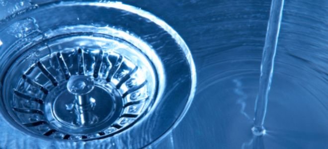

Water flowing into a stainless steel sink.

Your sink is perhaps the most well-used tool in the kitchen. You need it to help prepare meals, and to keep everything in the room clean. However, food scraps and congealed grease can stop up the drain over time, and when this happens you need to know how to unclog it. Follow the advice below for several simple, but highly effective methods to fix this problem.
Step 1 - Run Some Hot Water
Before you plunge or snake your kitchen sink, attempt to break up the source of the clog by running a steady stream of very hot water into the drain. This can help dissolve and/or wash away built up grime and grease. If this fails to produce any results after 10 to 15 minutes, you will most likely need to proceed to other solutions.
Tip: To prevent future clogs, allow hot water to flow down the drain for several minutes a week, to clear contaminants before they have a chance to present a problem.
