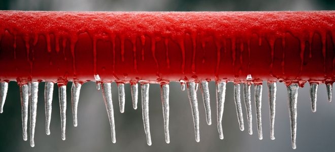

Frozen septic pipes can have disastrous results if left alone. The waste can be forced out, overflowing in your yard, or the expansion of the fluid can also cause the pipes to break. There are many different ways to prevent this from happening, such as wrapping and insulating exposed pipes, but they can still freeze depending on where you live and the local weather conditions. Use these guidelines at your own risk to try to solve your frozen septic pipe problem.
Warning: There are many times where it is best to hire a professional plumber to unfreeze your pipes or to work the equipment. If anything goes wrong with them, the pipes will definitely burst and this will be very expensive and messy to repair and clean up.
